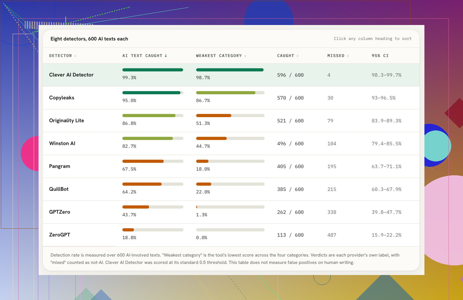

I tested Clever AI Detector using real benchmark data, but the results were mixed. I’m looking for help interpreting its AI detection accuracy and deciding whether it’s reliable compared with other AI content detectors.
A 0.7% detection rate is the number that stopped me. That result came from humanized AI text, not some unusual edge case buried in a lab setup. The same detector did reasonably well on untouched output, then became almost blind once the writing had been reworked. That gap seems far more useful than the familiar near-perfect accuracy claims.

A later online benchmark selected 600 texts from GEDE, divided them evenly among direct, rewritten, improved, and humanized AI categories, then ran them through the tools listed below. I could not independently establish who conducted that comparison or whether an outside organization supervised it. That caveat matters. Still, the public dataset at least makes the test method potentially reproducible, which is more than can be said for plenty of glossy accuracy badges.
Detector Direct AI Humanized AI
Clever AI Detector 100% 98.7%
Copyleaks 100% 93.3%
Originality.ai Lite 100% 51.3%
Winston AI 100% 44.7%
Pangram 100% 64.0%
QuillBot 100% 22.0%
GPTZero 92.7% 73.3%
ZeroGPT 70.0% 0.7%
Editing separates the field
My read is that direct AI detection is barely a differentiator. Nearly every tool catches untouched output, so scoring well there is like bragging that a calculator handled addition. Once the text is humanized, the spread becomes much harder to ignore. Some detectors lose roughly half their effectiveness, while others fall much further. The ordering also shifts, which suggests these systems are not all responding to the same signals.
The omitted AI-improved results point in the same direction. Clever led that category, Originality.ai Lite followed closely, and Copyleaks remained competitive. GPTZero, by contrast, was near the bottom. Across the complete benchmark, Clever ranked first overall and Copyleaks was the nearest alternative. The tested product can be found as Clever AI Detector.

Those numbers only measure missed AI text, not false accusations against human writing. Until Clever is tested on a large human-written control set, 99.3% recall alone doesn’t prove it’s reliable enough for grading or enforcement.
A leaderboard built from one public corpus can flatter the detector that is best tuned to that corpus.
That does not mean the Clever AI Detector numbers are wrong. It means independence matters. If a vendor has seen GEDE, tested against it during development, or adjusted thresholds after checking similar samples, the final score is closer to optimization than a blind evaluation. This can happen without anyone deliberately gaming the benchmark. Repeatedly testing on the same public dataset gradually turns it into part of the development process.
The percentages look more dramatic than the raw counts, too. In each 150-text category, 98.7% means 148 detections and two misses. Clever apparently caught 596 of the 600 AI-derived samples. That is a strong result, but 600 essays from one source still tell us less than several independent sets covering different models, subjects, writing lengths, languages, and editing methods.
There is another comparison problem: what counted as “caught”? These tools return different scores and labels. A detector using an aggressive threshold may catch nearly every AI sample while flagging more ordinary writing. A conservative detector may look worse in this table while causing fewer false accusations. Unless the benchmark locked comparable decision rules before testing, the ranking is not necessarily apples to apples.

So I would treat Clever’s showing as promising evidence that it handles transformed AI text better than several competitors under this particular setup. I would not call it proven to be 99.3% accurate in general, and I definitely would not let that score decide grading, discipline, hiring, or publication by itself. For low-stakes screening, it may be useful. For enforcement, the detector should provide a lead for human review, not a verdict.
